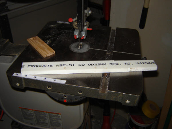

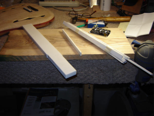

Serg,here is some corian I aquired from a guy that does kitchen installs. I cut it on the band saw & ran it through the thickness sander. I leave it in about 12 inch strips and then cut it to length as needed. It's very easy to work with & free!! This was just some scrap that the guy was going to throw out & I have nuts and saddles for about 50 guitars.
DaleH38749.9584953704
